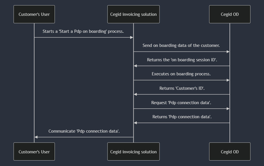

1st step: The Customer 'on-board' the PDP
The target of this step if to validate that the Customer's user has the need rights granted to execute the 'on-boarding process' and to provide him with all needed information allowing to the Pdo to subscribe in the Cegid OD in the customer behalf.
Below the flow of this step.
External PDP onboarding flow - step 1
Warning
The 'Pdp connection data' include confidential data allowing the Pdp to get connected to the Cegid OD (APIKey).
Accordingly, we strongly encourage you to handle this information with extremely careful!!!

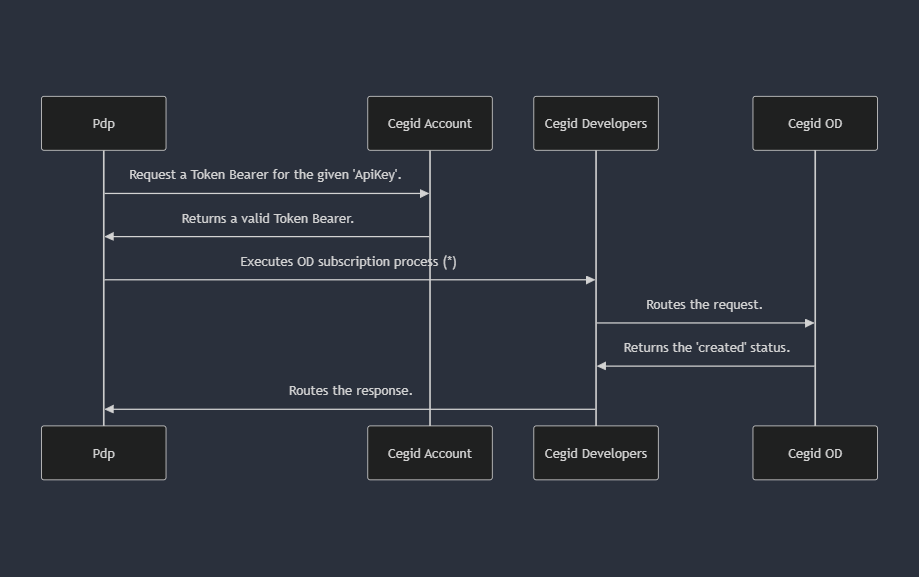

2nd step: The Pdp subscribe on the Cegid OD
Note
The PDP must formalize the corresponding cooperation contract by contacting Cegid's commercial department.
After this process, the Pdp team will be able to manage their own access to Cegid Developers(*).
This subscription key belongs to the Pdp and it should be used whatever the Customer being managed by the request.
The main objective of this step is to register in the Cegid OD how it can notify/communicate all information concerning the eInvoices of the Customer.
Important
The Pdp MUST provide an exclusive endpoint for each on-boarded Customer (^1).
After this step, the Pdp and Cegid OD will be able to exchange about eInvoices.
External PDP onboarding flow - step 2
(*) This request MUST bring the Pdp subscription key for Cegid Developers managed by the Pdp.
