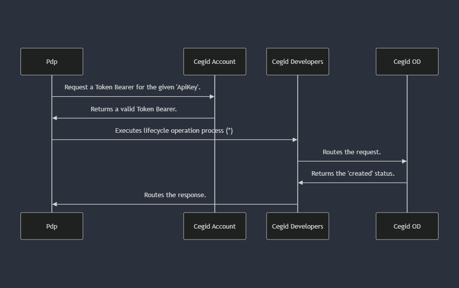

External PDP sending lifecycle messages flow
(*) This request MUST bring the Pdp subscription key
Warning
The Token Bearer generated by Cegid Account can be used in several calls, until their expiration, concerning the same Customer perimeter (Addressing line granularity).
We strongly encourages to put in place a cache mechanics and do not perform a new request on every call.
