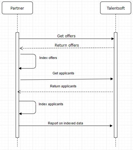

2. Process
2.1. Data exchange
Data Exchange

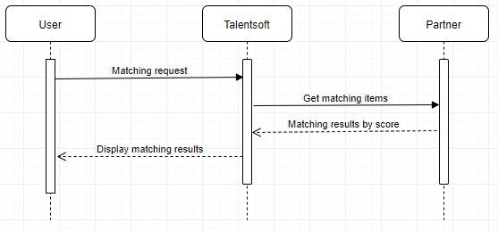

2.2. Matching
Sequence diagram
3. Data indexing
Talentsoft provides APIs which allow partners to retrieve all their vacancies and candidates to index them. These REST APIs are in JSON format and use client credentials of the OAuth 2 authentication type. (https://www.oauth.com/oauth2-servers/access-tokens/client-credentials/)
The Talentsoft back office API documentation is available here: https://partner2-bo.dev.talentsoft.com/api/documentation/index
Talentsoft provides partners with one client ID/client secret per client for authentication purposes and to use the back office APIs.
The Talentsoft back office API URLs are different for each client. They are in the format: https://<client>.talent-soft.com
When deploying the Matching feature for a client, the partner must index all the Talentsoft vacancies and candidates already available to the client. Obtaining the data must be done in a progressive manner and consider the possible impact on Talentsoft platforms.
Care must be taken when obtaining high volumes (several thousands) of candidates. The partner must prioritise obtaining the last 3 months of data so that they can offer the feature straight away, even if it is a reduced version of the feature.
The client must be informed that the indexing procedure may take several days. Partners must regularly call the Talentsoft APIs to obtain new vacancies and candidates which have been added/modified since their last call.
Partners can subscribe to an notification system (webhook) in order to receive notifications when vacancies or candidates are created/modified.

5. Matching candidates to vacancies
The objective is to display candidates (and their scores) in decreasing score order beginning with those which are the best fit for a given vacancy.
When the user opens a vacancy's "Matching" tab, a request for the list of the most appropriate candidates is immediately sent to the partner.
The partner uses their REST API to perform a GET request to find the parameters in the query string and returns a JSON data response.
After the exchange format between Talentsoft and partners has been approved, the complete specifications for the API are provided by Talentsoft in the Swagger file format here: https://recruitingmarketplacespecification.talent-soft.com.

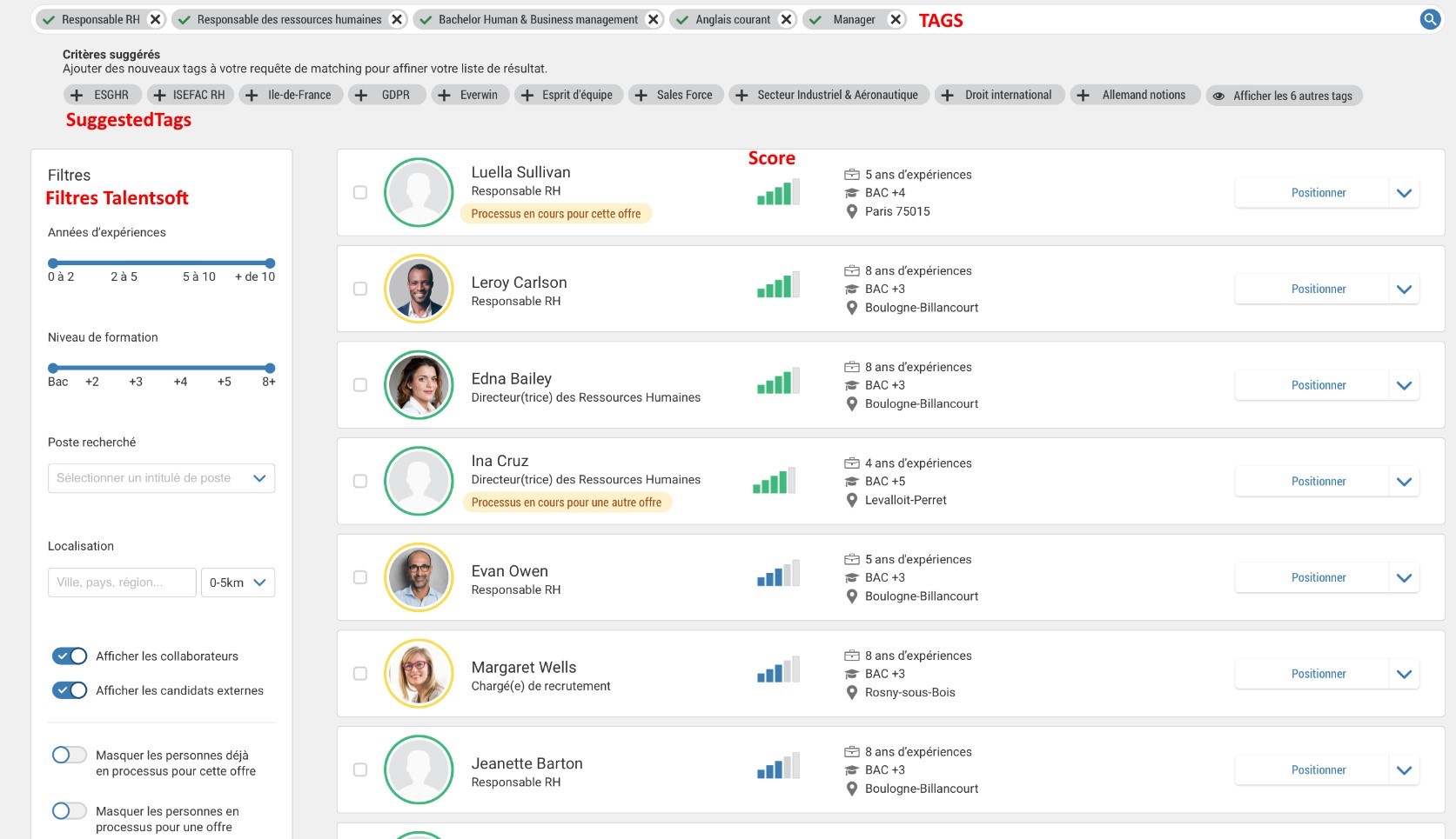

5.2. Response
The response is provided in JSON format and must contain the list of candidates sorted by decreasing relevance to the search.
The response includes the following fields:
  • vacancyReference: the Talentsoft reference for the vacancy which was matched (path in the vacancy details JSON: $.reference)
  • tags: list of partner tags/competencies applied to the search (see below for the description of a tag)
  • suggestedTags: list of tags/competencies suggested by the partner
  • applicants: list of candidates who correspond to the matching request (see below for the description of a candidate)
  • content-range: pagination details in the format [offset]-[limit]/[total count]

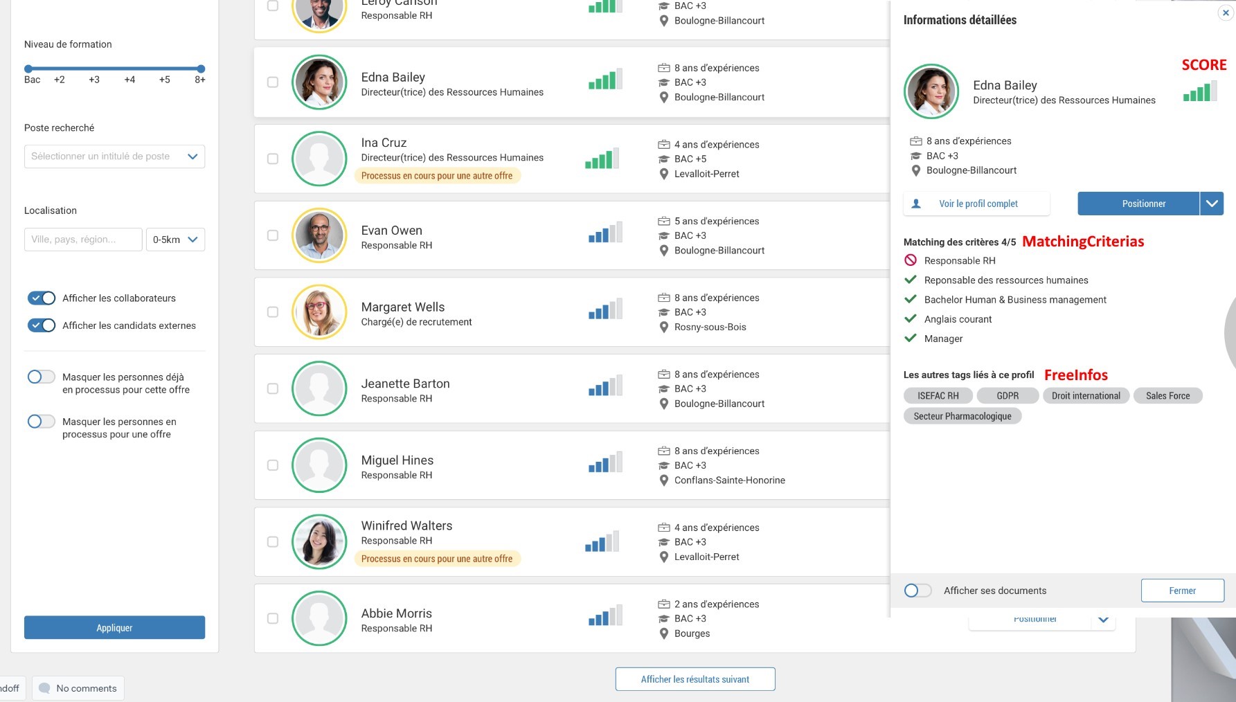

5.2.1. Candidate
The returned candidates have the following properties:
  • applicant_id: candidate's username (path in the candidate file JSON: $.candidateDetail.id)
  • score: matching score as a %
  • matchingCriterias: the list of criteria which were matched, or not (details provided)
  • freeInfos: a table of character strings in the requested language containing information from the partner (not required)
The matching criteria object (matchingCriterias) has the following properties:
  • label: the name given to the criteria in the requested language
  • match (true/false): true if the candidate meets the criteria
  • weight: the weighting of the criteria (not required)

5.2.4. Mock-up
List of results:
resultlist mockup
Candidate details:
resultlist-mockup
