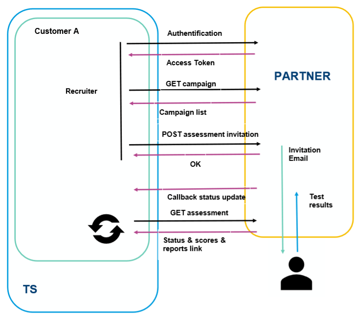

The purpose of this document is to describe the process of integrating assessment partners. The concept of a campaign must exist with the partner.
A campaign is the link between one or more tests to be given to the candidate and a job or offer. (It can be a product or a package or…) If the partner has a test library, Talentsoft will not be aware of it. The management of the tests to be administered remains on the side of the partner. And it is the partner's responsibility to make the link between his test library and the campaigns. To invite candidates to take the test(s), the recruiter must select the corresponding campaign and then send the invitation. When the recruiter displays the page of a candidate who has completed a test, the status of the test will be refreshed. The status of the test may also be refreshed after a notification of a change of partner. Finally, the test status will be refreshed once a day per batch. When updating the test, an overall score (%) and a global report will be retrieved. It will be possible to retrieve several other scores and reports. The scores should allow candidates to be compared on the same campaign. Reports can be PDF files or dynamic HTML. Only scores will be stored by Talentsoft, reports will only be available for consultation.
Exchange overview
